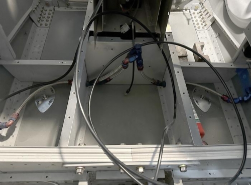

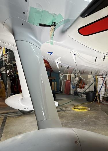

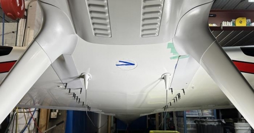

Brief Description:  VHF antennas
VHF antennas
I made matching doublers for both VHF antennas and used them to match drill corresponding holes in the belly skin after many measurements. They worked out well and wil be sealed around the edge with silicone during permanent installation. Next for the ADS-B (in/out) transponder antenna.
