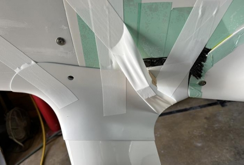

Brief Description:  02 - Upper gear leg intersection fairing - port
Having trimmed back the wing root fairing a bit to exactly match the starboard side, I needed to back fill the intersection fairing to match. I scuffed the inside of the fairing and applied two layers of 200GSM carbon with 410 micro over the top, which I'l smooth off to transition into alignment with the wing root fiaring for minimum wind resistance. I may have to do the same on the other side ... time will tell.
