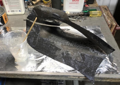

02 - Upper Gear Intersection Fairing (UGIF) - Port
I filled some air pockets on the inside with epoxy and Aerosil. Once that set I smoothed, reinstalled on the fuselage and added two more layers of 200GSM twill weave over the top to stiffen the part and rejoin the front edge. It worked out well.
