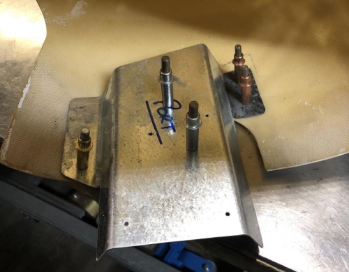

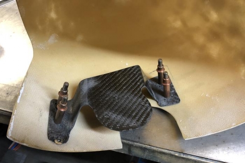

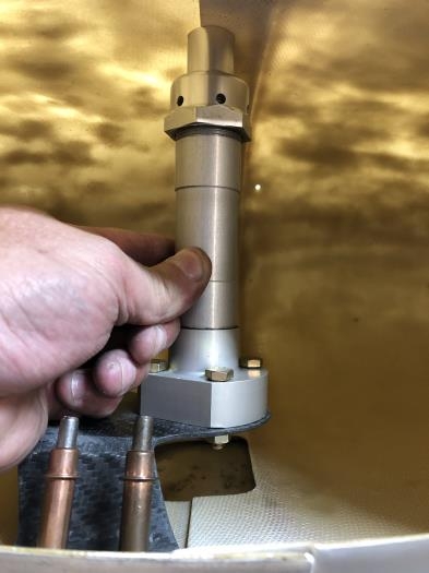

Wheel pants
I drilled the attach bracket for nutplates and then used the mould to exactly align the part to the longitudinal axis of the pant before match drilling the pant on one side. Once that was done I removed the mould, match drilled the other side and checked the alignment with the axle. The axle is about 1" forward of the fore/aft join line where it should be and a minor trail adjustment can be achieved by moving the 1/4" axle nut hole slightly forward later on. Overall I'm very happy with the result.
