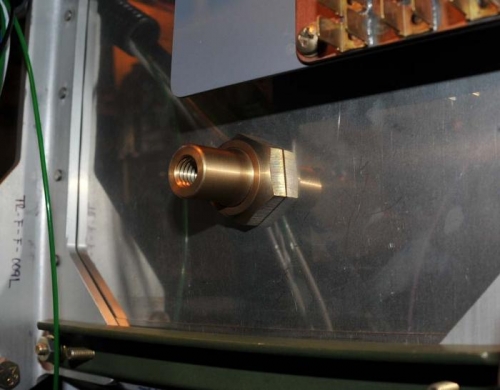

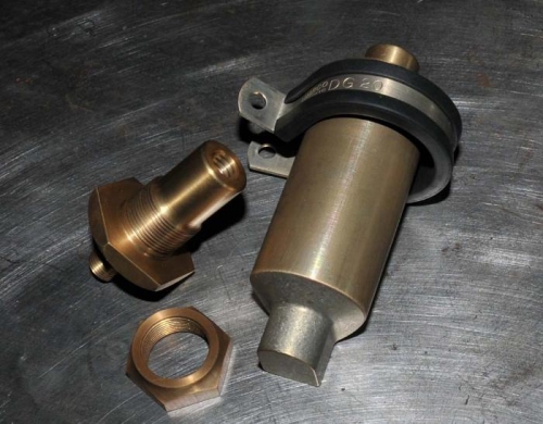

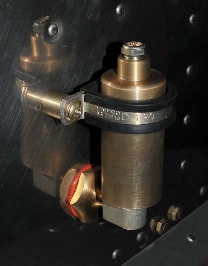

Brief Description:  02 - Brake fluid reservior
I turned a matching nut and silicone washer, Alodined, drilled the firewall, fitted a nutplate for the support P-clamp and installed everything ready for the Speedflow banjo bolt, AN-3 fittings and 200 series hoses to the bottom of each brake master cylinder.
