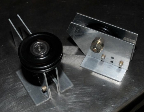

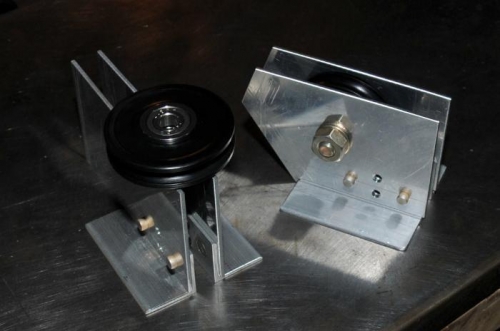

Rudder pulleys
Tonight I started fabricating brackets to support the rudder pulleys. I'll trim these down substantially once I've worked out the mounting angle and where the mounting rivets should go. I'll use a clevis pin to stop the rudder cable jumping out of pulley when the cable is limp.
