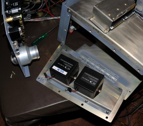

Brief Description:  EFIS backup batteries
