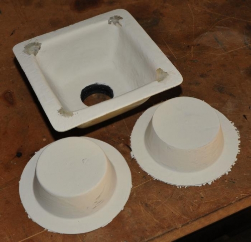

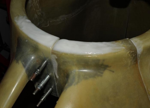

We had a power failure in the neighbourhood tonight, so I worked by gas light to fill some holes on the dipstick access well with Aerosil and epoxy. I roughed up the spinner flange area of the cowl and put the leftover Aerosil on to start building it up where the two cowl halves meet.
I mixed a small batch of Upol Reface filler and painted the plenum cups and dipstick access well. I'll add more if needed after sanding.
