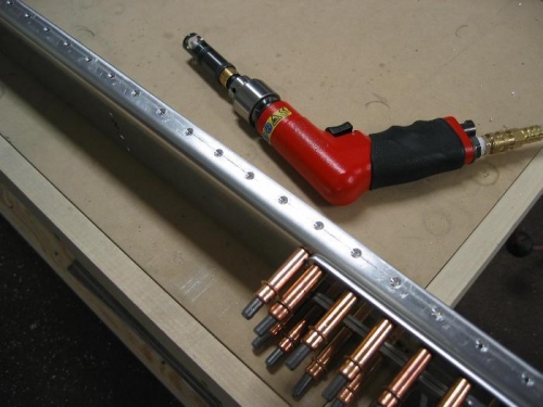

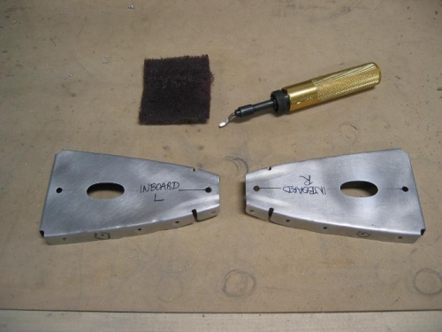

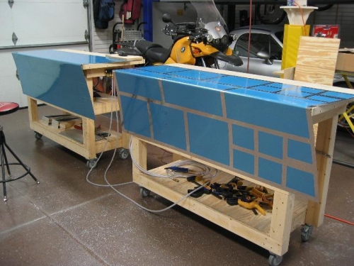

I spent most of the day today countersinking the front spar and stringers, which took a lot of time due to the sheer number of rivet holes involved. Then I cut out the oval holes for the rudder cables in the two inside nose ribs using a Unibit mounted in the drill press for the rough cut and a small, Dremel-mounted sanding drum to finish the edges. I also deburred the inside edges of the #40 holes on the flanges of the rear spar. Finally, I marked and removed parallel strips of blue vinyl on one of the skins along the outside edges of the rivet holes in preparation for deburring and dimpling.
Countersunk Front Spar

Cut Out Ovals on Nose Ribs

Remove Vinyl Strips for Rivets
