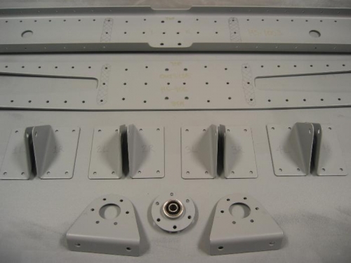

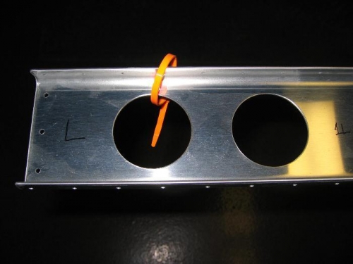

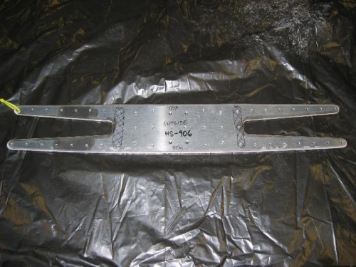

After about a week's break from building, I tagged the parts with tie wraps prior to cleaning so I could remember the orientation once everything was clean and the alignment marks were gone. Then I scrubbed all the aluminum parts down with Alumiprep 33 and a Scotch-Brite pad, rinsed and dried everything, and then re-applied all the alignment marks with a Sharpie pen prior to priming. On the powder coated parts, I skipped the Alumiprep and just scuffed the surfaces with a Scotch-Brite pad, rinsed and dried, and then re-marked the parts. Once everything was prepped, I primed all of the components with Mar-Hyde 5111. I used masking tape on both sides of the flange bearing to keep primer out of the bearing surfaces.
Rear Spar Tagged with Tie Wrap
Doubler Tagged with Tie Wrap
Rear Spar Components Freshly Primed
