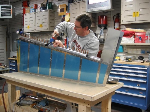

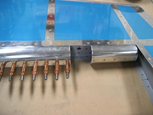

Today Gordon Broich came over and helped me buck the rivets in the top rib. Then I used his 1-1/4" pipe to roll the leading edges of the rudder. Once the rivet holes were aligned, they were clecoed, match-drilled, and then riveted using blind rivets.
Top Section Riveted
Top Section Riveted
Riveting the Middle Section
Leading Edge Complete
