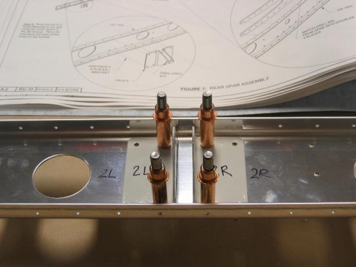

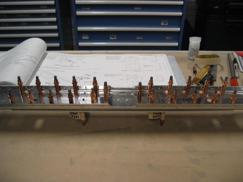

Today, I finished deburring the rear spar and also deburred the rear spar doubler. Then I match-drilled the spar, doubler, and hinge brackets, leaving 6 holes undrilled per the plans, and marked everything for final assembly once prepped and primed. I also assembled and match-drilled the inboard hinge bracket assembly.
