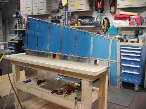

Brief Description:  Trial Fitting of Rudder Assembly
Since the next series of steps involves ProSeal, which has a limited working time after application, I spent the rest of the evening doing a trial fit-up. This will help make the final fit-up go faster while the ProSeal is still wet. Tomorrow morning, I will drive over to Gordon's house to borrow his pre-drilled angle iron to use as a straight backing plate for the rudder's trailing edge while the ProSeal cures.
Trial Fitting of Rudder Assembly with Clecos
