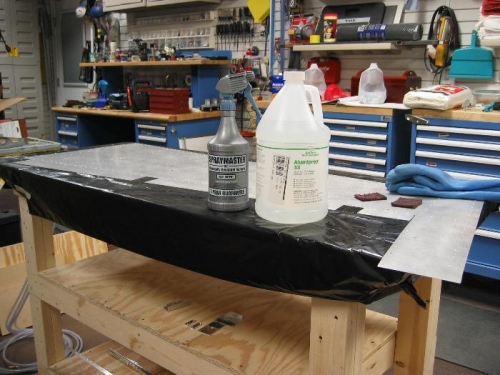

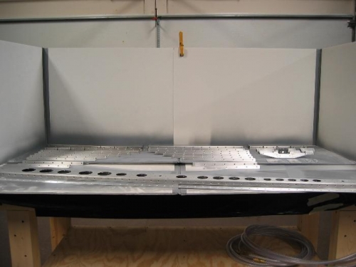

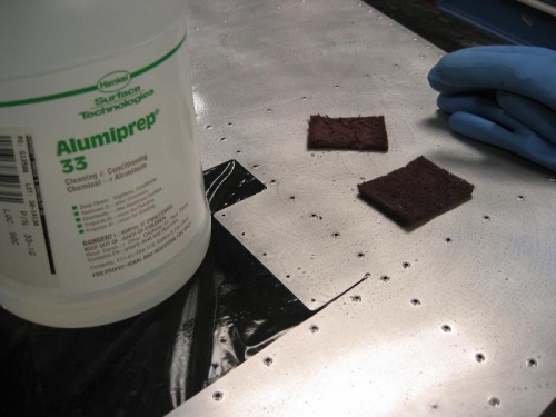

This afternoon and evening, I went through the tedius process of prepping all the parts for priming. I diluted the Alumiprep 33 with 3-to-1 with water, and applied it with a chemical spray bottle that I purchased at Home Depot. Every part was sprayed, scrubbed with a Scotch-Brite pad, and then rinsed off before the Alumiprep solution dried. Tomorrow I will prime the parts in preparation for final assembly.
Prepping Skin for Priming
Alumiprep 33 in Use
Alumiprep 33 in Use
Prepped Parts Ready for Priming
