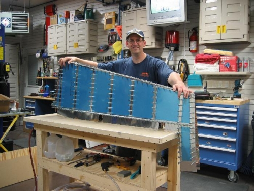

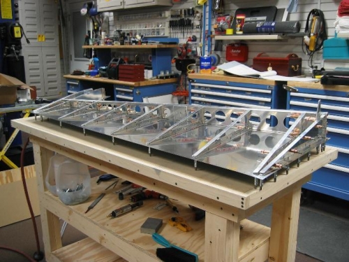

Spent the rest of the evening installing the skins on the skeleton, lining up holes with a thin punch, and then holding everything together with Clecos. Now that the skins are installed, and the AEX wedge is held in place on the trailing edge, I can match-drill the skins tomorrow.
Skeleton with One Skin Installed
Both Skins Installed with Clecos
