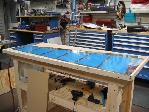

I spent the first part of the day match-drilling the skeleton set up last night. Then I disassembled the parts and deburred the spar, reinforcing plates, and the #30 match-drilled holes. Afterwards, I prepped the skins for assembly by deburring all edges and marking and removing vinyl strips around the rivet lines with a soldering iron.
Removing Vinyl Strips Around Rivet Lines
