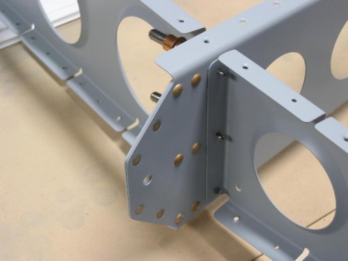

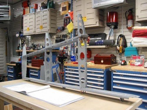

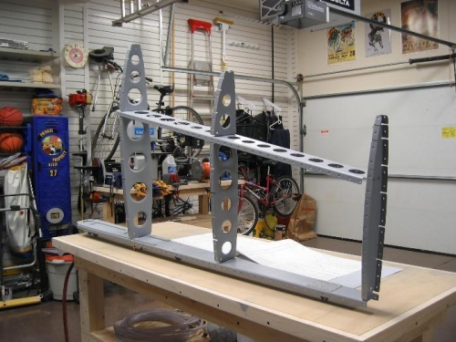

After the inside surface of the skin was primed, I re-assembled the skeleton and riveted the top and middle ribs between the front and rear spars. I left the bottom ribs clekoed together for now per the plans, since those pieces will be removed for temporary rivet bucking access later when installing the skin.
Lower Ribs Clecoed In Place For Now
Riveted Skeleton
Riveted Skeleton
Awaiting Skin Installation
