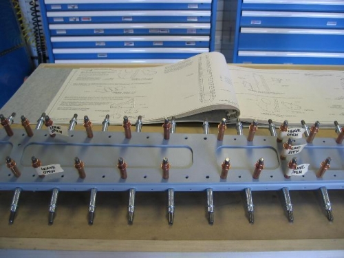

Began assembling the rear spar, now that the primer has cured. Clecoed everything in place before driving any rivets to ensure proper alignment. Installed flagged clekoes to mark holes to be left unriveted until later.
Rear Spar Clecoed Together
Marked Holes Not To Be Riveted
