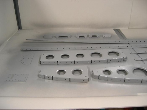

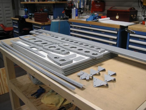

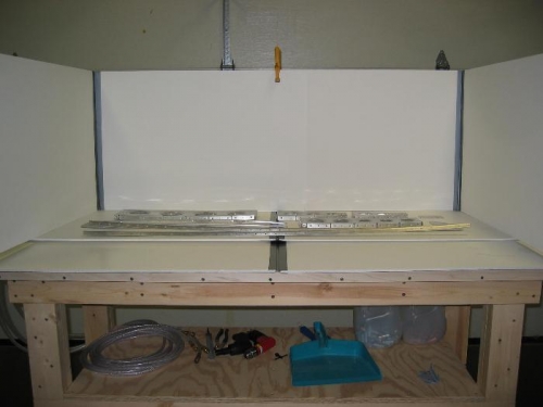

Most of the day today was spent preparing the rest of the skeleton parts for priming, with several more hours of scuffing, followed by a thorough degrease with acetone. After the parts were thoroughly prepped, I applied two coats of Mar-Hyde self-etching primer using the mini paint set-up assembled earlier today.
Skeleton Parts Ready for Priming

Two Coats of Mar-Hyde 5111

Primed & Ready for Riveting
