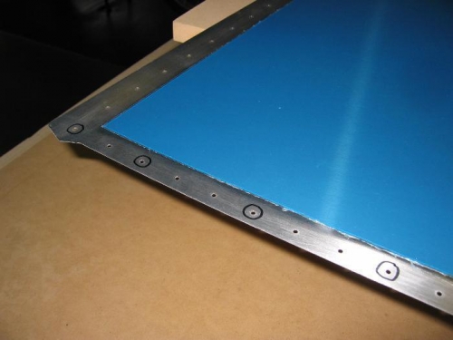

Marked Holes On Bottom Row Not to be Dimpled

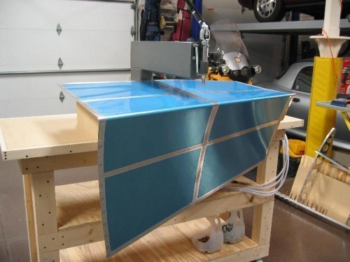

Set Up Dimpler & Platform

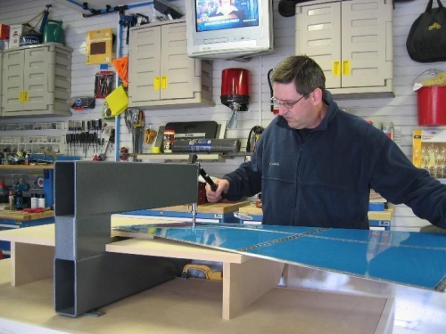

Me Dimpling the Skin (for the FAA)
