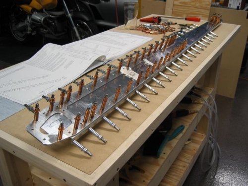

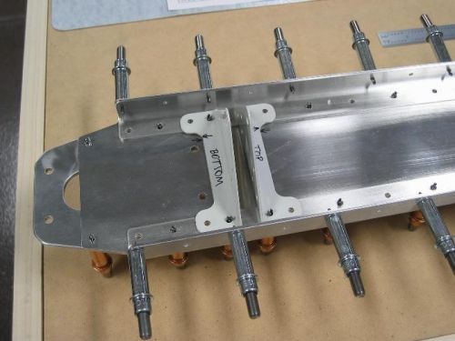

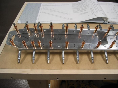

Finshed work on the rear spar assembly. Match-drilled the 3/16" upper attach bolt holes of the rear spar and rear spar doubler. Countersunk all of the #30 holes on the forward side of the spar doubler below the 3/16" upper attach bolt holes for 1/8" flush rivets.
