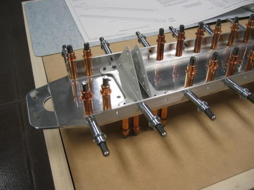

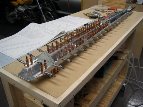

Continued deburring the rear spar doubler. Clecoed the rear spar doubler, rear spar, L & R spar caps, rudder hinge brackets, and hinge doubler in place, and reamed all holes with a #30 reamer.
