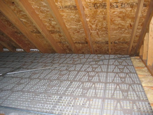

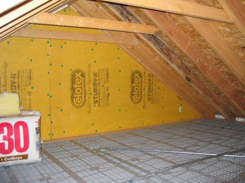

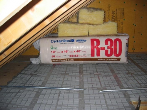

Brief Description:  Attic Dek Floor (1)
Started installing Attic Dek (www.atticdek.com) floor panels in the attic storage space. I bought 5 boxes of the 16" panels from Amazon.com, and it looks like I'm going to use every last one of them. Lots more layout work than I thought, due to the electrical conduit running above the joists. That's going to require some custom fitting work to maximize useable floor space. However, I managed to get most of the floor laid out by the end of the day. Man, was I hot, tired, and sore! There are few projects in life more difficult than crawling around on your hands and knees all day, dragging tools around over open joists filled with Fiberglas insulation, in a 130 deg F attic with limited airflow! :-/
