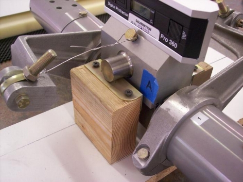

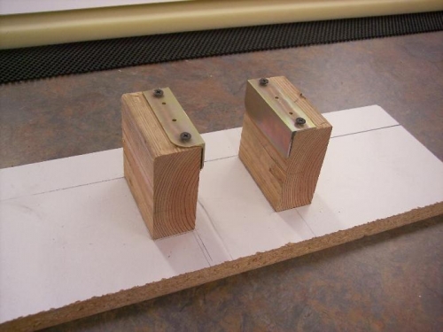

Brief Description:  Static Balance Jig
I've seen other builders use a jig like this one to do the static balance of the blades with. The manual also states that it can be done with two steel parallels while sitting on the helicopter. The jig is real simple to construct. Using aluminum angle made it easy to provide a solid even surface for the teeter points to rest on.
