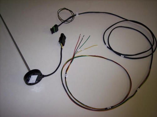

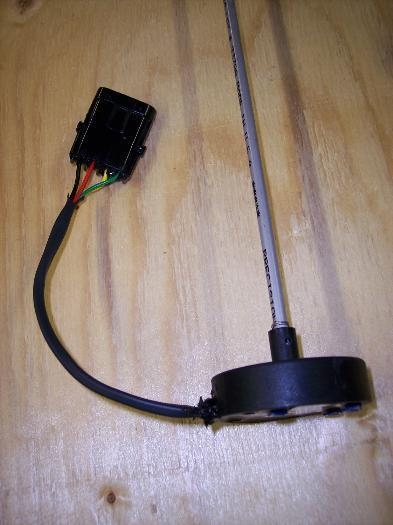

Brief Description:  Fuel Qty Probe Wiring

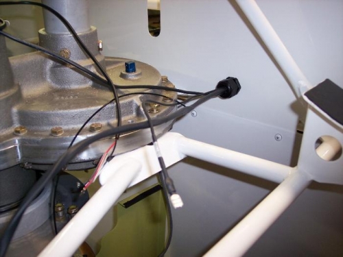

I found a good quality water-tight connector at McMaster Carr to use for the fuel probes. The extra coiled length of wire on the end of the harness is to electrically ground the fuel tanks to the frame. I included this on each probe harness.
I'm finding that the electrical wiring is taking an unusual amount of time. A lot of it is due to the fact that I'm not an expert on wiring and I tend to make sure everything is "just right".
Since the plans have virtually no info on wiring techniques, I've based my personal standards on what I've seen on the military aircraft that I've had the opportunity to work on and the typical FAA reference materials. It may be overkill, but as an example, I've decided that any wire that extends through the firewall is to be encased for abrasion protection. This has required the making of over a dozen wire harnesses. I've taken the time to mark each harness and log it with each conductor's color and purpose. The wires on the inside of the firewall will be seperated and protected by a combination of shrink tubing, sleeves and spiral wrap.

Fuel probe with disconnect
Probe with harness
Probe with harness
