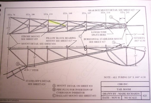

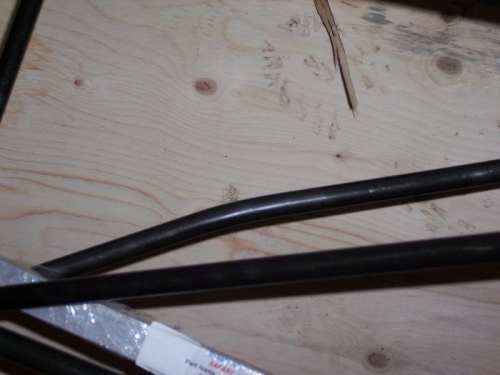

Brief Description:  Straightening the Tailboom member
To help ease the bend out of the tube, I made a die to use with some "C" clamps. I routed out a 3/4" trough in a solid piece of Hickory hardwood. I then lined the trough with a piece of leather to cushion against the tube. By using the "C" clamps, die and a long piece of steel angle, I was able to remove the bend. My only concern is a few small nicks left by the forklift blade in this area. I'll consult with the factory and replace the tube if advised.
