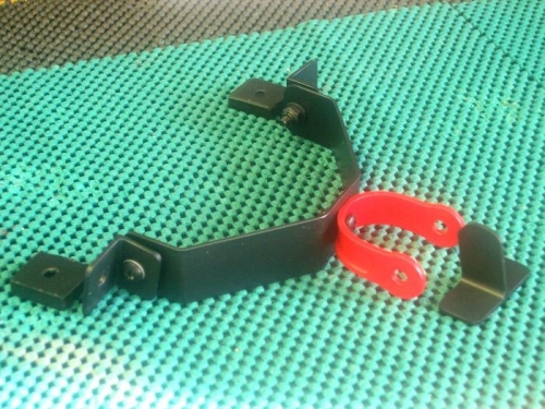

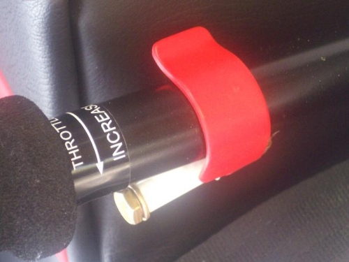

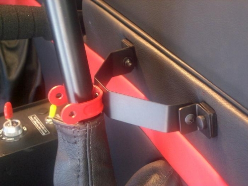

The Safari doesn't have any control friction devices and these shouldn't really be used as control locks anyway. The Construction manual provides good drawings so you can make up a set of effective locks. I would have preferred a less bulky cyclic lock but it is functional. I ordered a Kwik-Lok release pin from McMaster-Carr for the cyclic lock and another one for the rear blade support bracket used when trailering the ship.
I used a red colored rubberized plastic dip coating (like what's used on plier handles) to help protect the control sticks. The material is available in a dip or spray version at most larger hardware stores.
Collective lock
Collective lock
Individual pieces of the cyclic lock (lock pin not shown)
Cyclic lock
Cyclic lock
