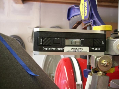

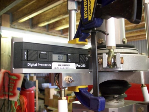

Brief Description:  Rigging the Flight Controls
After static balancing and installing the blades the swash needs to be leveled. I found that I was able to get the swash plate level and got the required degree of movement except when collective was pulled. Lowering the swash just a little allowed the full 8 degrees of tilt in all directions with the collective pulled. It all sounds simpler than it actually is. The rigging and balancing would go much better if I had someone experienced with the Safari giving me a hand. I'm working on getting someone from the factory out to help after the air show season is over.
Digital protractor
Digital protractor
