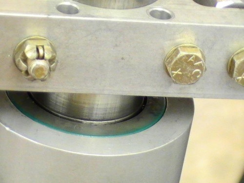

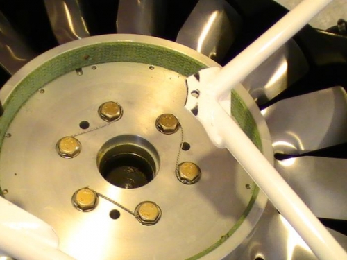

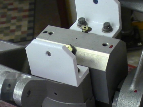

I received the parts back from the factory after tear down and inspection. The main transmission came back with the new Speedy Sleeve mod under the seal. The rotor head now uses the new nickel plated steel yoke caps with the special high strength bolts. I did notice that a different type of clutch lining is now being used. The main shaft also got a new seal where it enters the top of the transmission. The old one had leaked since new.
Speedy Sleeve Installed under main shaft seal
New Clutch Lining
New Clutch Lining
Steel Yoke Caps and new style bolts
