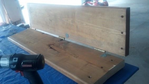

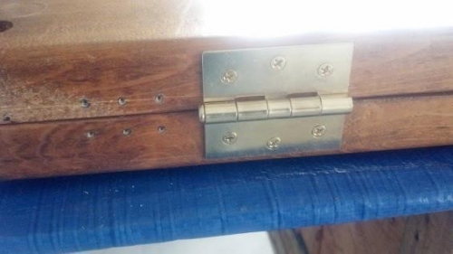

Today was a busy day. I first started by repairing the hinged bender to finish bending the elevator skins to the proper angle. I used much sturdier hinges with staggered holes so that the wood wouldn't split. That worked well. I then bent the right and left elevator skins to the proper angle to give the trailing edge a much sharper edge.

beefier hinges worked great
Back in business to bend the trailing edge

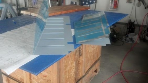

Comparison of the left bent skin bent with the right which is not bent yet
