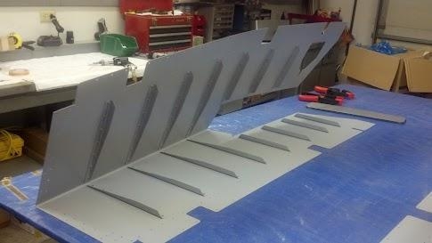

Number of Hours:  2.32
Manual Reference:  6-8
Brief Description:  Back riveted the stiffners on the elevator skins.
Today, I back riveted the stiffners on to the both the right and left elevator skins. This really was just more time consuming than difficult. The flush riveting came out perfect as you can see from image 2. I had to order a #6 spring back dimple die to dimple the trim support plate for the plate nuts holes. I will try to get past this step while I await the dimple die to arrive and do other things further down the line. But I hate moving on and leaving steps unfinished. But no choice here I guess.
Left elevator
Left elevator
