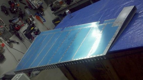

Brief Description:  Riveted on Skins

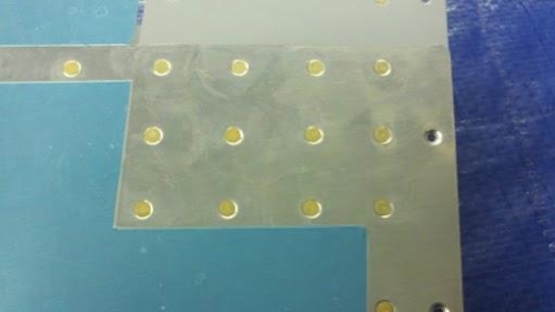

Today I riveted on the skins to the skeleton and finished placing the tabs that I constructed one of the fiberglass fairings that I will put on later. The trailing edge is left to do and then rolling the leading edges together. Then I will place the hinges. I highly recommend using the flush rivet sets with the rubber edge as it really help to prevent it from skiping across your skin and dent the shizit out of it. It works great and you can see the results below in the second picture. All the rivets look like this when set with this rivet set.
Called it a day.
Skins riveted on except for trailing edge.
Example of the not to shabby flush rivet work.
