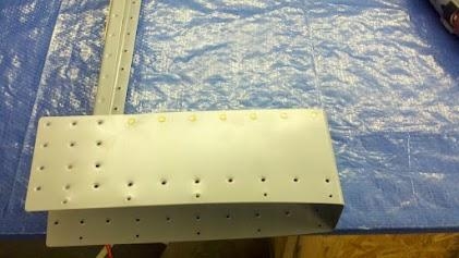

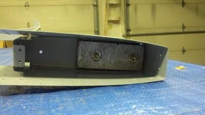

Today I riveted on the counterbalance skin to the counterbalance rib. I then bolted on the counterbalance weight. My new flush rivet set really work well not to slide off the mark and cause unwanted dents.

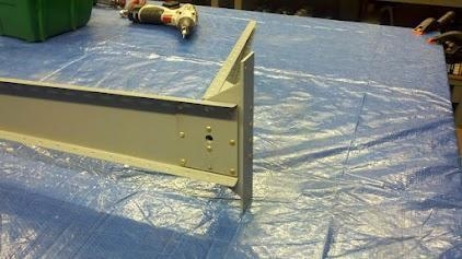

I had to remove several rivets from the lower rib and put on a part that I should have put on first. That was not fun. But it came out OK. I then re-riveted the R-904 rib as before. This is illustrated in the pics.
Next step was to cleco the skins on the spar. That was easy. I had to shave some metal on the inferior leading end to get the skin to slip on over a brace properly. Easily done with the straight aviation snips and deburred with the dremel and coned sanding bit.

Counterbalance skin riveted onto the counterbalance rib.
Counterbalance weight bolted onto the counterbalance rib
Lower rib and assc parts riveted together 1
