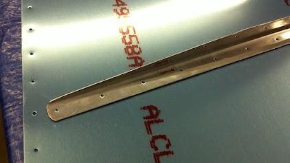

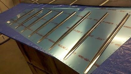

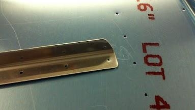

Brief Description:  Finished trimming and then finishing the Rudder st
Today I finished preparing the rudder stiffeners. I used my variable speed dremel to saw off and taper the aft ends of the stiffeners. I then etched each stiffener, labeling them, so that I knew where each would go on the left and right rudder skins. Next, I used the bench grinder to round and smooth all the edges. That is all I had time for today; so I called it a day.
Stiffeners as they would lay out on the left rudder skin
Nice finished aft taper and rounded  edges
