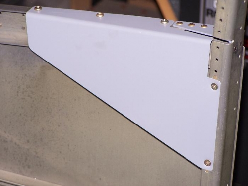

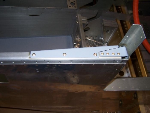

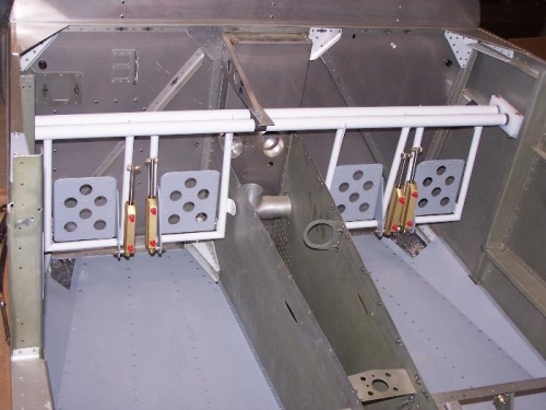

Started the day removing the previously assembled rudder pedals from the frames and re-primering them. I re-assembled them and then mounted the assembly in the airplane. Discovered there is plenty of room for feet on the floor without any interference. After lunch, I put nut plates on the top forward rails (F-1040) after removing the temporary riveted corner pieces (F-1042E) and machine countersunk the holes for the screws holding the vertical sides of the wire covers (F-1042G).
Rudder pedals mounted without the center bearing block
F-1042E and top portion of F1042G
F-1042G-R showing the countersunk screws
