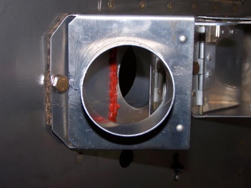

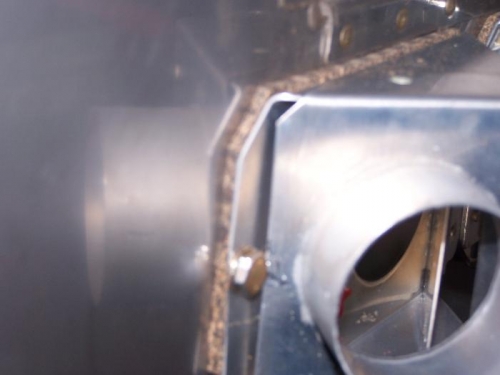

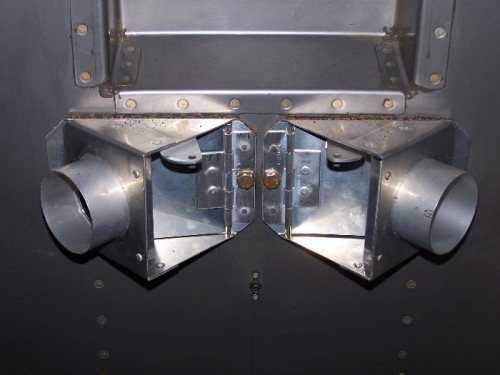

I put a rubber and cork gasket behind each of the valves to insulate the firewall from the heat system. I also added a bead of RTV sealant behind the flap to act as an air dam to keep the air from trying to open the butterfly when it is supposed to be closed.
Valves completed
Valves completed
This shows the RTV
This shows the RTV "air dam"
Gasket material should withstand the heat
