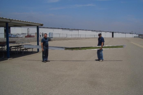

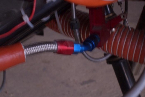

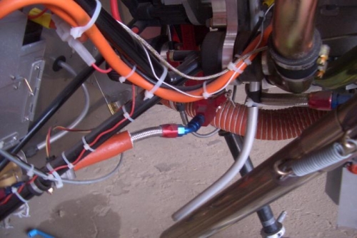

The first picture is me and Russ C holding his main spars after mating. Picturee 2 & 3 show the tubing leading to the carbeureter (with red connector) which we removed to make the fuel flow test. The 1 pint container was held under the tubing outlet while I turned the fuel ON and OFF from inside the cockpit. The times to fill the container were 28.4 secs and 25.03 seconds for and average of 26.7 secs/pint or 16.7 gal / hour. I splke to John Shablow. He idicated he was faxing my application to the FAA. Expect to hear back week after next. (week of 5/28)
Russ & me jholding his spars
See the silver/red connector
CU
CU
