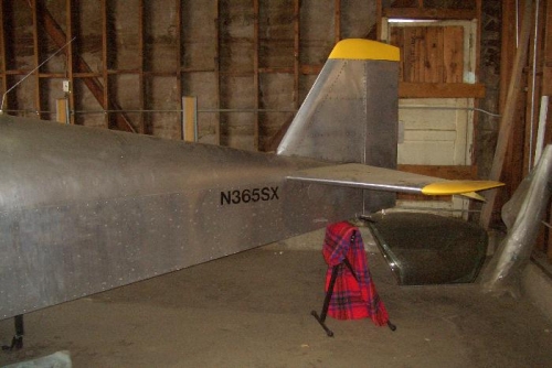

Brief Description:  Plumb pitot, install cowling, place N #
First thing was to plumb the Pitot tube system and trim remaining tubing. On the morrow I'lll install a clamp on the tubing. Next I installed the cowling. All but one hinge pin fit nicely. And the Dzus fasteners went in all but one. On the morrow, they go in.The interior was then installed. Then I made the plane official by placing the N number (N365SX) on both sides of the the tail section. Lastly I sat in it and made airplane noises. TOMORROW THE ENGINE STARTS AND TAXI TESTS BEGIN!
