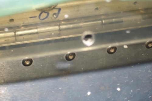

Brief Description:  Prep drill canopy to frame
The one hole drilled in the system resulted in a hole 1/8" from the bottom edge of the canopy. Too close for comfort. The solution is to re-drill the hinge half and the square tubing about 1/8" up and to the rear. And then drill the plastic. If that doesn't work. I've got a hinge half with wider flanges. The problelm with this approach is holes must be postioned within the side of the square tubing. Oh well...win some lose some.
Hole close bottom edge
