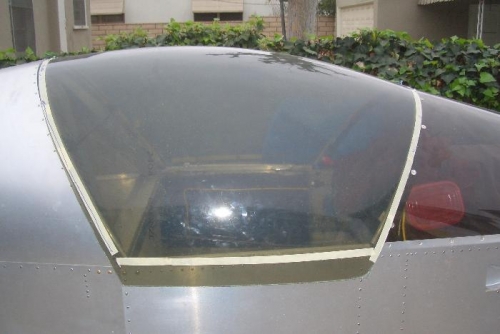

Brief Description:  This was the day to tackle the canopy
Happy Birthday. This was the day to tackle the canopy. Kerry suggested care and caution and others recommended temperatures over 80 deg. So we did both. The garage was heated for work in there. Thanks to Russ Clifford for his help. The canopy is really a two man job moving the plastic canopy without placing any strains on it. We got the canopy rough trimmed. Fore and aft fit nicely and the sides will be trimmed tomorrow. Then I can roll the front half of the plane into the warm garage with a shroud over the entry to keep the heat in. Actually, I'll roll lthe whole plane forward but only the front half will be in the garage.
The canopy in fore and aft
View from the front.
