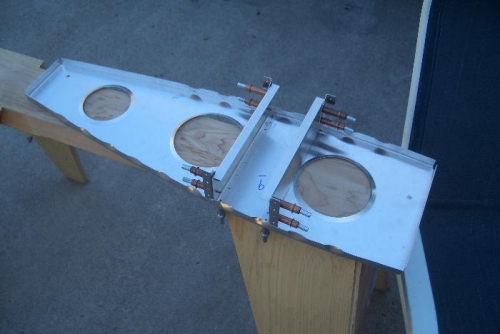

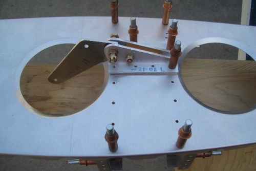

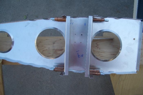

Brief Description:  Getting #9 Left aft rib ready to rivet
The four support clips were located and fastened to support rails, drilled to #40 then #30 and deburred. The bell crank was locate and drilled to size. Everything was disassembled, deburred and reassembled, ready to rivet.
#9 rib showing support  rails
#9 rib showing bell crank
See bell crank thru the lightening hole
