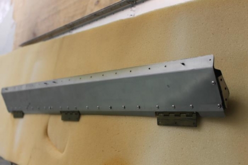

Brief Description:  Elevator Trim
Located all pieces, deburred and filed rough edges, primed mating surfaces.

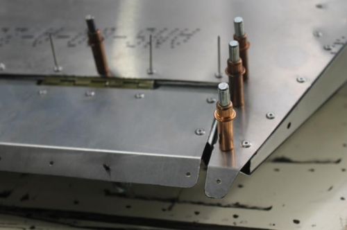

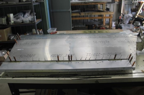

Trim went together OK until attached to elevator, then rib on trim rubs against rib on elevator. Spoke to an experienced builder as this is first time bits didn't fit together perfectly, just need to tap in one of the ribs to provide free movement.
