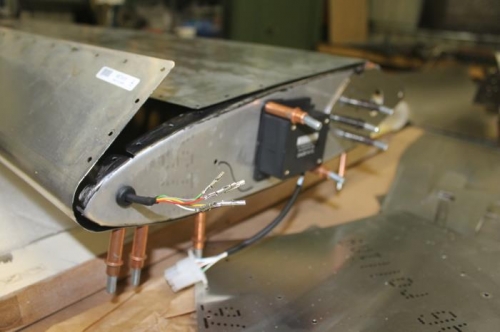

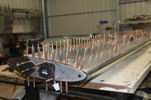

Final part went together quite well, nose skin was just a matter of taking your time and slowly tightening some straps and as the holes line up insert the clecoes.
Also put attachments to the end so tips can be held on with rivnuts.

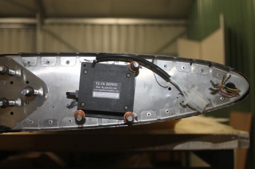

Have just been told servo has been installed on wrong side. Have de rivitted part of nose skin so I can to cord and pass it through coming out the correct side. Makes sense when it placed next to the elevator.
I'm getting good at de rivitting process, rather than drilling through the rivet completely by drilling the rivet so the head is removed and the using an automatic centre punch most times the rivet just pops out. Saves a bit of time but most importantly less chance of making the hole too big.
Will post some up dated photos later with servo on correct side.
