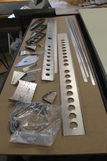

Locating all parts, then deburring holes and filing edges of all rough cuts. Then assembled frame before dismantling to prime parts as required.

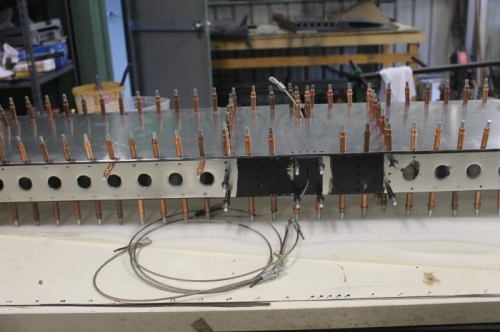

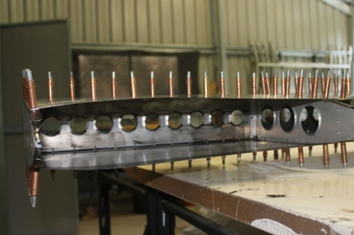

Reassembled stabiliser, riveted internal frame however just clecoed skin. Have passed the cable through. Looking at other parts of the manual also helps to understand which way the cable goes.
Front skin appears bowed however when this occurred in the past it always seem to sort itself out.
Some of the pictures further on in the manual don't appear to match with the parts list? appears that the tips attach to the stablizer via rivnuts and a flange that is included in the kit but not mentioned in this part of the construct. Just need to take things slow and steady.
