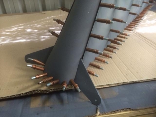

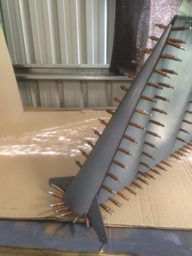

ST515 needs to be bent a bit more to fit. Works pretty well by gently bending and adding clecoes.

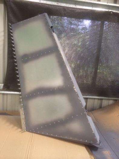

Once or the clecoes are in just need to swap with rivets. all going together quite well except I forgot the plastic tip, never mind just means i'll need to drill out some rivets along the top when I add the tip.
