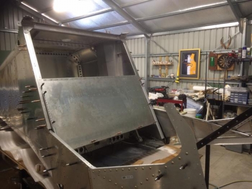

Brief Description:  Extended Baggage Assembly

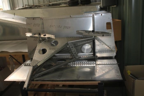

Difficult to understand the order in the instruction manual sometimes but luckily an experience builder Rick is helping me out with some directions when needed. He has said that he instals the controls onto the seat back rest and baggage floor in one piece. This saves trying to fit later from underneath.
I do need to drill holes into the fuselafe side here but with the extended baggage comes a jig so the holes are easy enough to get right.
When the extended baggage area was installed i was ready fot the seat back/baggage sub assembly to be installed. I should have waited to install the 2 carters ST134 and ST135.
The cross bar SF157 took a bit of work to get in place with all the holes lining up, then also had to work on the back rest fitting right but in the end all OK.

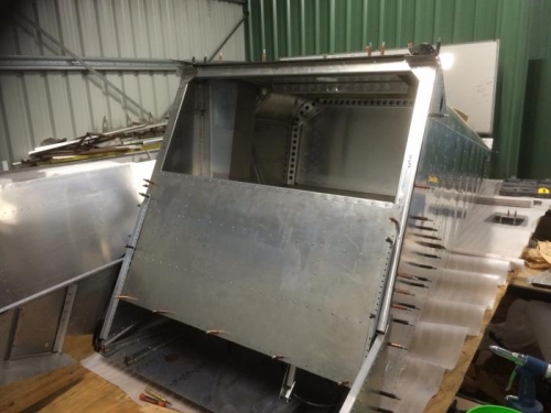

seat back/baggage floor sub assembly
All in place ready to rivert
