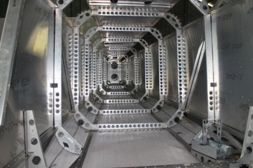

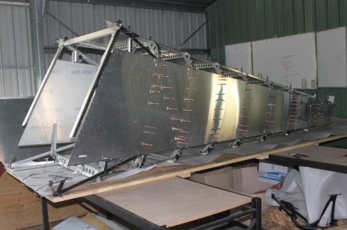

Brief Description:  Rear Fuselage Assembly 2
Initially putting on the skins went smoothly, once I had the top and bottom skins plus the 2 sides in place it was suggested that I should leave the top skin off until I had installed the bottom edges. The idea was that if when installing the rounded edges the tabs on the frames are pushed out of place it will be a lot easier to get them back in place with one side open. Makes sense. You will also have had the practice to make sure you get it right before closing up the final side.
All this means I had to remove the clecoes off the top skin and put it aside for the time being. Glad i hadn't riveted it yet.
