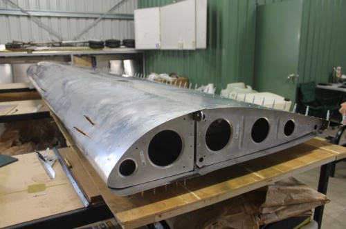

Finalised the nose skin and could remove straps once rivets in. A few dimples when nose skin meets ribs, seems pretty common with most Savannah's, Saw a tip where another builder injected an expoxy between the skin and the rib preventing the dimple, works a treat so most of the dimples are now gone.
I haven't installed the wing door support yet as it will only need to be removed to instal fuel system later.

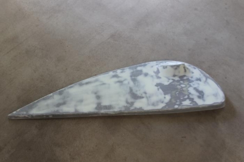

Have filled the wing tip with body filler to give smooth surface for later painting
Wing tip
Wing tip
