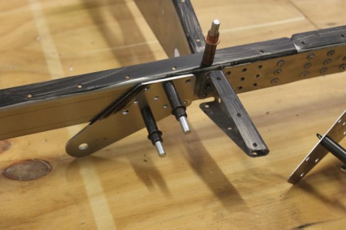

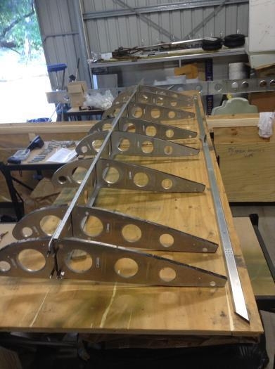

Started on the wings, the first real big job. Located parts to frame clean and deburred all holes and edges. Painted mating services with "the black paint"
Manual says to rivet and bolt strut attachment SA083, have only clecoed this until bottom skin is in place so rivetting near strut attachment will be easier. Rivetting attachment needs to be completed prior to top skin being put in place.
Bottom skin clecoed in place, would have liked the cut outs where fuel tanks go to stay in place but they fell out when lifting the skins out of the box
