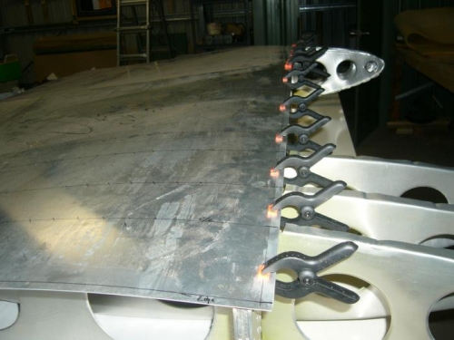

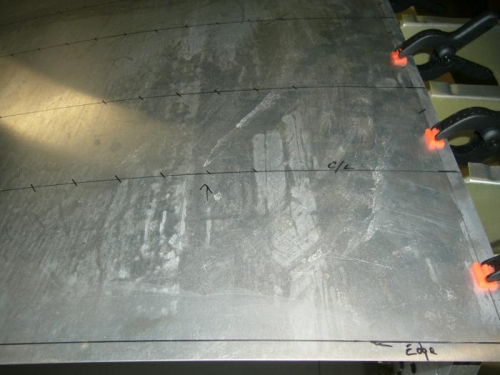

Now that I'm happy the skin is sitting where it should be and clamped in place, i have drawn lines where the main and rear spar is as a guide to where rivets will go plus also line to the centre of the ribs.
Marking the rivet position is next, want to make them evenly spaced.
